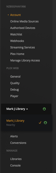

Screen Shot 2022-10-24 at 11.45.49 PM
This is all I see under “settings”. I have also tried “Restore Default Settings” but nothing has changed.
