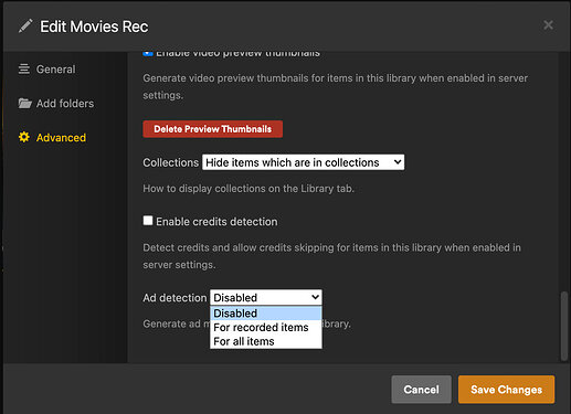

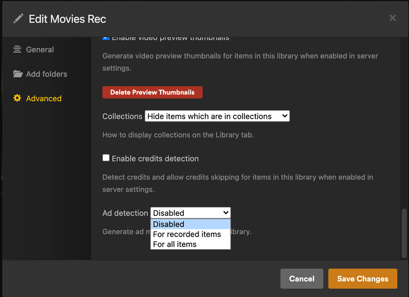

From the Plex Media Server Announcements thread:
I believe that this comes default to “For recorded items” instead of the “Disabled” you would think it would be.
To configure this you need to go to EACH library of Movies or TV Shows Type and select Manage Library > Edit and then select the Advanced tab from the sidebar and scroll to the bottom. Should see an entry like this:
Hope this helps. Good luck!
Chris
Thanks Chris
I thought that I had checked this but sure enough, all libraries were set set “For recorded items”.
