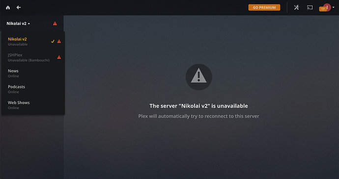

So when I try to use plex to connect to a server a colleague has shared with me I can’t connect to it, and I also can’t connect to my own server in general. I’m not sure if it’s a problem with Plex or something bigger than that. It was working when I first was using it, but then it just stopped. If anyone has any suggestions it would be much appreciated

At the moment, I uninstalled both my malware and the possible vpn application, and I’m still having the problem, I’m assessing the issue on my macbook, so I’m not quite sure if that has anything to do with this either.
