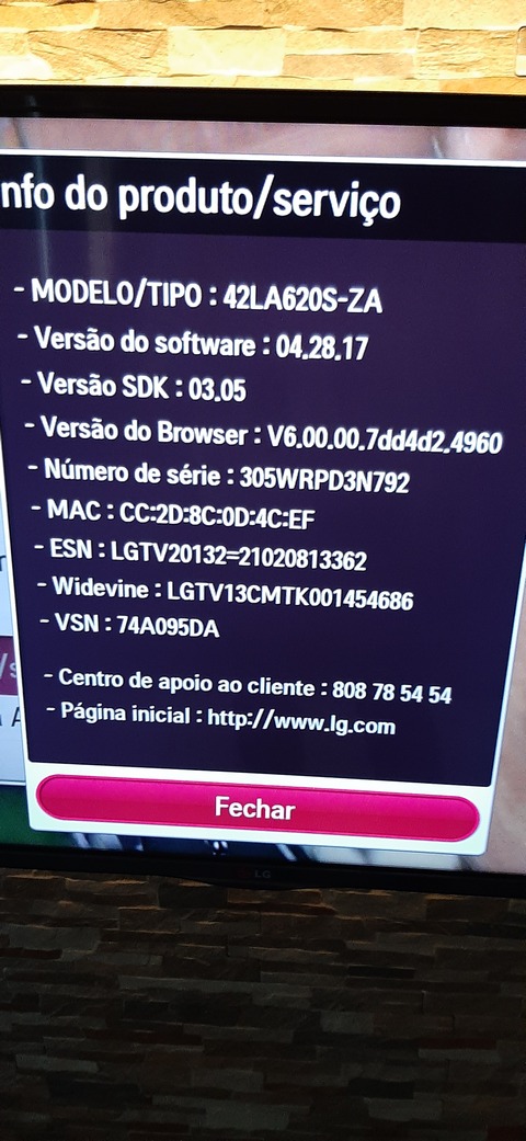

I have this problem
Can you please offer more information.
This information can be found on the Server. Settings/Authorised devices
Server Version:
LG Client version:
WebOS version:
Using WiFi or Ethernet.
I cant open the app.
It happens with booth connections
I have the exact same issue, tried uninstalling plex client , then plex sever and re-installing and even factory resets but no avail
