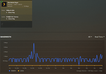

I was also able to find a movie which I am able to play directly.
And thanks a lot for helping me, I really appreciate it.
Never verbose unless specifically asked.
That image looks wrong. It shows it’s direct playing an 18 Mbps file but the graph only shows an average of about 1 Mbps. My guess is something is not reporting back to PMS correctly.
