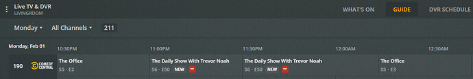

Greetings. On Monday of this week, all of the episodes of The Daily Show with Trevor Noah airing at 11:00 PM EST on channels 190/690 this week had the incorrect episode length: 30 minutes. By Tuesday of this week, the EPG for all the episodes had been corrected to have the correct episode length: 45 minutes. As of Thursdayf this week, all of the episodes of The Daily Show with Trevor Noah airing at 11:00 PM EST next week have the incorrect episode length again: 30 minutes.
For next week, it appears that the EPG has a new episode at 11:00 PM EST for 30 minutes (incorrect length), and another airing of the new episode at 11:30 PM EST for 45 minutes (correct length), but that listing for the second airing is not accurate.
This issue is very inconvenient, as I am constantly adding and removing 15 minutes of padding to the scheduled recording to ensure I get the entire episode recorded, so that I do not miss the final 15 minutes of the episode. I have already filled out a request in the Plex EPG Lineup Inaccuracies form, but I fell this issue may require an additional investigation.

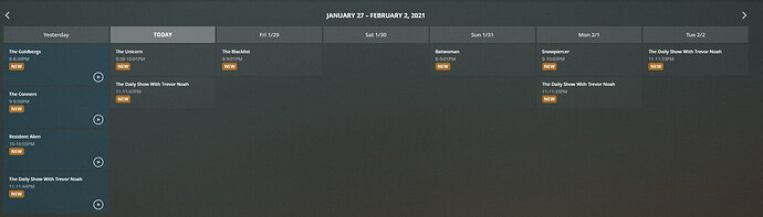

As of today (Jan 29), the episode length for the airings during the week of February 1 and the week of February 8 is incorrectly set for 30 minutes.
As of a few minutes ago the guide has corrected itself, and all five episodes this week show as 44 minutes long. Next week’s episodes are still listed as 30 minutes long.
