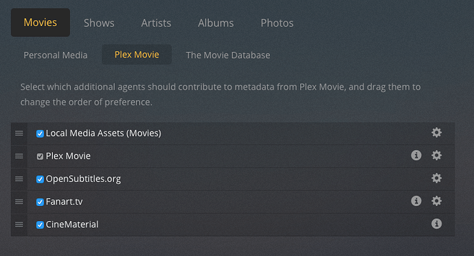

Show me your Settings - Server - Agents. Those persist (maintained by Plex.tv) .
@ChuckPa Here are the agent settings.
