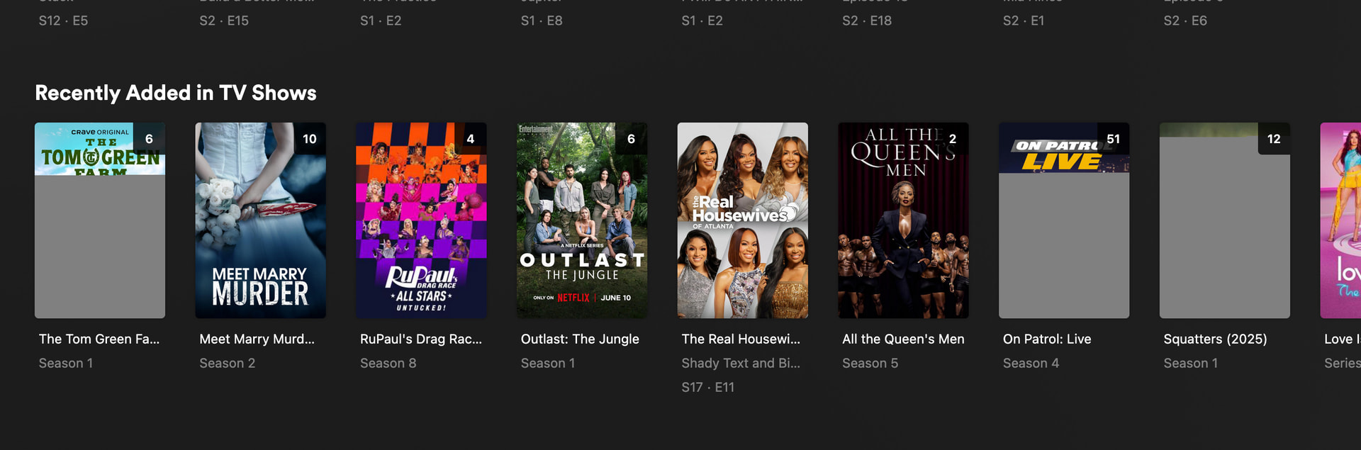

I have noticed many of my posters are not downloading fully.
Trying to refresh the metadata on the series page produces the same error mentioned above.
Even after manually selecting a ‘full’ image poster, performing a Metadata refresh will still produce the error.

It appears that either my artwork for Season Two of Third Watch, as found by Plex, is causing the issue. When I removed my custom artwork, the issue returns immediately.
This is how the Season Two poster selection shows after removing my custom artwork, with the issue present.
