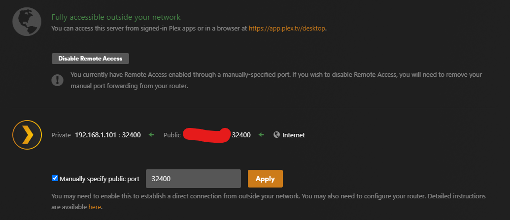

I’m having an odd issue where some of the clients on my plex server are having a direct connection while others do not (including some of my own devices inside my own network).
A bit of context to my situation:
  1. I have fully accessible remote access outside my network.
  2. I have manually specified a 32400 as my public port.
  3. My server is on a static ip of 192.168.1.101.
  4. DNS is set to cloudflare on both IPv4 (1.1.1.1 primary and 1.0.0.1 secondary) and IPv6 (2606:4700:4700::1111 primary and 2606:4700:4700::1001 secondary)
  5. I do not use a VPN.
  6. My current setup is a modem with router functionality set to bridge mode, along with my primary mode.
  7. My server is connected as follows: Modem → PMS. It is not connected to the router which is as follows: Modem → Router
  8. I have read the following guides on the community forums: First, Second, Third
What I don’t understand is why I can’t get a direct connection for all of my clients, including myself? Why do some clients have a direct connections while others don’t and how can I fix it?

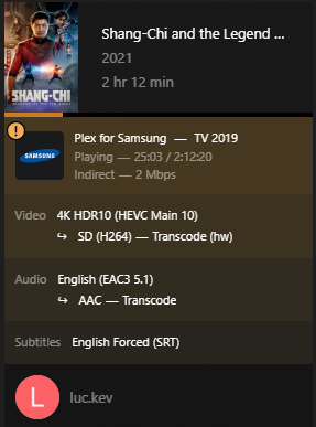

For reference, Shang Chi snippet is streaming locally.

If you see indirect inside your own network it’s either due to a fractured network (i.e. more than one router) or due to a misfiring “DNS rebinding protection” in your DNS resolver (which also usually sits in your router).
Scroll down to “why doesn’t it work?” in here: https://support.plex.tv/articles/206225077-how-to-use-secure-server-connections/
