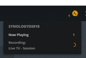

I use roku on each TV to run plex. Here is a screenshot of what the plex activity dropdown look like when I am watching a show (live TV that is being played - NOT recorded):
As you can see it shows that 1 show is playing but it additionally shows that there is a recording. After taking this screenshot I went back to the roku and exited plex back to the main menu. When I came back and looked at the activity dropdown there was nothing there (which I would expect since I stopped playing). I believe this indicates that the recording corresponds to the show being watched even though only the play was selected. I tried this a couple time with the same results.
I don’t remember seeing that a live tv show being watched is also recorded before but I am being very observant since plex messed up and didn’t record shows as I described in earlier posts to this thread.
