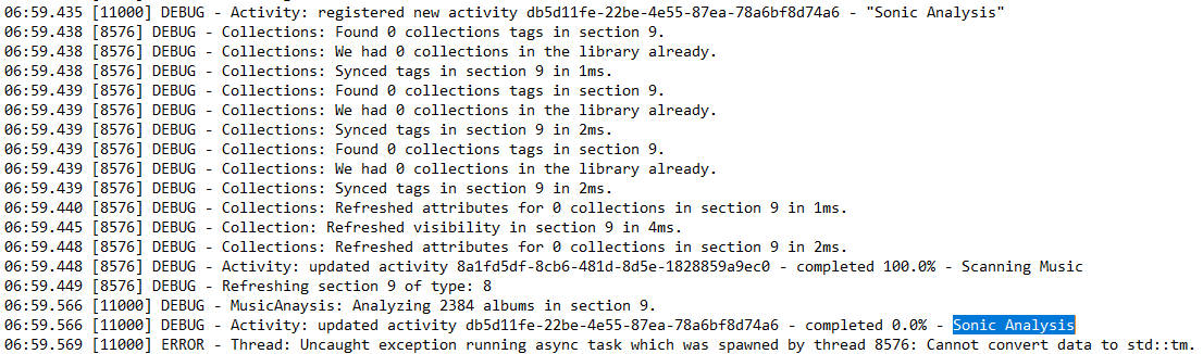

My music library is roughly 6,600 albums, and over 2 days of running 24hrs, SA had reached a little over 60% complete. Then for some reason the server shut down and when SA resumes, it makes zero progress and eventually shuts down. In the log files, I’ve run out of troubleshooting talent because I can’t even determine which album it’s trying to analyze to give myself a starting point.
Steps I’ve tried:
Listen to albums ripped in …\AppData\Local\Temp
All latest albums in the folder above completed their conversion to wav with the exception of one that was missing the last track. The last track just happened to be an MP3 where the others were FLAC. I removed the mp3 file, updated libraries and restarted PMS. SA hung without completing any albums for over an hour.
I started deleting other albums that were in the folder above and repeating the update library/reboot PMS steps. Same result with SA hanging for a long time, although the album count to complete would change. I decided to let it run to see if I was just being impatient… eventually SA stops but there’s no progress made.
I tried renaming the folder in AppData\Temp to see if that would trigger something same result. Then tried moving them to another folder, same thing.
System:
Windows 10 Pro 64-bit
Build 18363
CPU i7-8700 3.2GHz
16GB RAM
PMS 1.24.1.4931

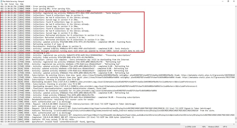

I wish there was a logging level between Debug and non-debug, because I can’t seem to get much history from the files now. I don’t have any log files left from when SA was running properly, but the attached are from my latest attempt (I kicked it off for the last time around 2am, so there is some time before and after in these log files). During this run, SA never reduced the album count and stopped running at some point.
Appreciate any help, I’m all out of ideas (4.2 MB)
