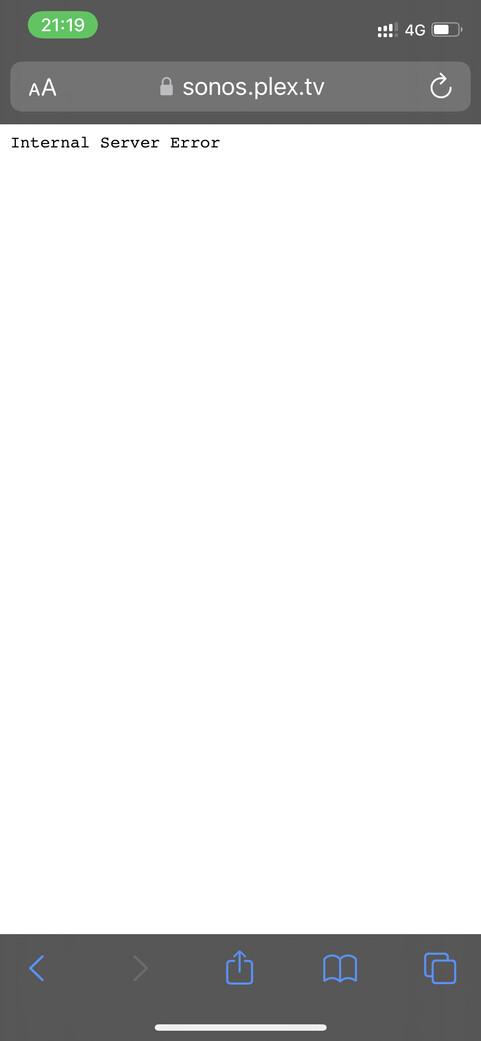

  2. Rather than trying to perform the link while on your home network/WiFi, instead try doing so from your cell phone or tablet when on a 5G/4G/mobile connection. That way, you’re on a completely different network (in case it’s something odd on your local network interfering with things).
Dear @chrisc
Thanks for taking the time to help me.
I’ve tried from my iphone/safari/4G. still the same: internal server error.
Shall we state that the issue is not related to my home network?
Thanks for your awesome support !

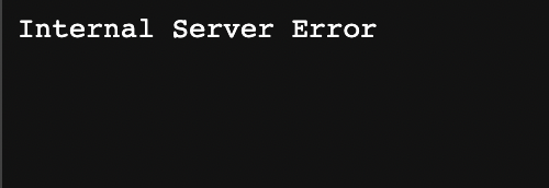

I have the identical problem as the original poster. Lifetime Plex Pass subscriber since 2018, Sonos user for multiple years, but this is the first time I’m trying to get the two to work together.
When I visit Sign In | Plex and try “Link your Sonos account”, I also see an “Internal Server Error”. I get the same result if I try to click the equivalent “Link your Sonos account” link in the players menu of the Plex web client. This is the Plex account associated with my forum account.

Our team was investigating this area of things again and appear to have found some old, stale info related to Sonos cached with your account. (I don’t pretend to know all the technical details here, so I don’t really have details to give.) They cleared that info out, so please go ahead and try linking to Sonos again from your Plex account.
Thank you for the quick assist, @chrisc!
After the fix on Plex’s end, I was able to link my Sonos account immediately. I can now see my Sonos speakers in the players list in the Plex mobile app.
It turns out this Plex account issue was also preventing me from using the Sonos app to access Plex. Earlier, I could add Plex as a music source in Sonos (successfully doing the authorization step in that case), but would immediately see the unhelpful error “Unable to browse music library” in the Sonos app when choosing Plex as a source. Being able to link my Plex account to my Sonos account in the Plex “Other Services” settings corrected that issue immediately.
