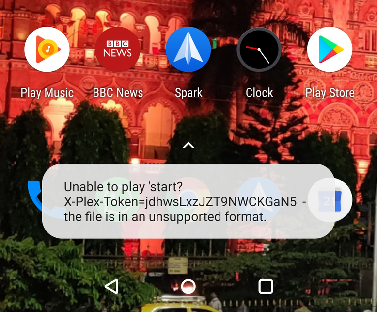

Inside the Plex Android app, I can play music fine through my phone, but when I try to cast it to the Sonos One, a receive the error shown below:
When using Alexa to request Plex music on the Sonos One (which is set up with Alexa), I receive the following error message from the Sonos app (assuming it’s open on my phone at the time):

    The Windows Sonos App shows the various error messages that come up when a track is failing - Unable to play ‘Plex’ - the file is in an unsupported format
    -Unable to play 'start?X-Plex … ’ the file is in an unsupported format

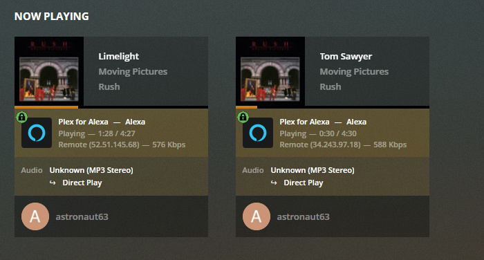

This screenshot shows the failing streaming to the Sonos on left and the working streaming to Echo on right

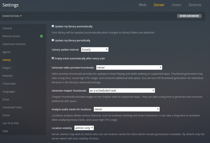

I have also disabled Plex for reanalysing the files Settings->Server->Library and then scroll down to Analyse audio files and set to Never. (default setting is as scheduled task )

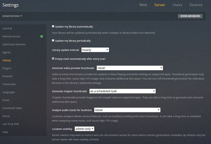

I solved it (as described here ) by removing the analysis that Plex does overnight (loudness analysis)
Test it out by adding some new music (or deleting say one artist, updating and then restoring)
Just make sure your server settings are set to never analyse
I now can play all my plex songs by voice request on the Sonos One. (I had to remove and then add back all music so this did take a whiel for all the metadata etc to be retrived)
Thanks astronaut - tried it with a sample album and seems to have worked. Now begins the long process of re-adding all my music!
From what I understand, there’s no way to submit a bug report to Plex developers right? You just have to attach a log file to a forum post and hope it gets noticed?
For anyone else looking, go to Settings > Library > and set ‘Analyze audio tracks for loudness’ to Never.
