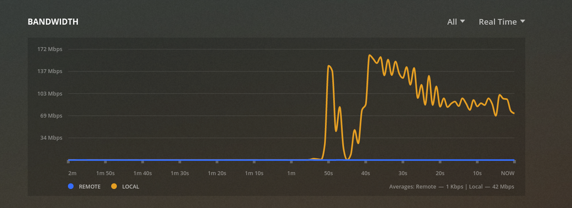

I had the same problem on my XF9005. Even though WiFi could easily go up to 200Mbit/s on IPerf tests, streaming from the Plex server was capped at 75/80Mbit/s.
I could not understand why until I figured that the main difference could have been that the Plex App was using encryption.
I told the App to use insecure connection when on the same network of the server and now I can watch 4K HDR content with high bitrate:
Update: I noticed that the latest versions of server and client use HTTPs even if you allow insecure connections on the client. My XF9005 caps at 60Mbit/s, probably due to forced stronger, and more expensive, encryption. To make this work you have to disable secure connection server side too. Which might not be ideal if you plan to use your server from the Internet. For me it’s not a big deal as I access my server form outside my network using a VPN. If there is a way to disable secure connection only for the internal network, server side, I didn’t find it.

Turning off secure connections on my server/client resolved this same issue with 4K HDR content on my Bravia X900E!
I legitimately want to buy you a beer, PM me some paypal/venmo details or something…
