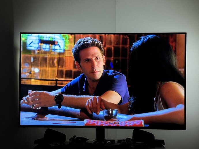

Specific show/file has incorrect resolution/aspect ratio
Server Version#: 1.40.4.8679
Player Version#: Roku: 7.22.9.9360-c3f590b75-Plex, Web: 4.134.2
On the Roku, a specific 1080p show has a weird aspect ratio. If I force it to transcode specifically to the 12mbps version, it shows up correctly (oddly the 20mbps option still shows the aspect ratio). I have 2 TVs both with Rokus running the same Plex player version - both have the same experience. Pictures attached. Other shows/movies in different resolutions all work as expected, as well - its very specifically this show using direct play.
The stream info shows as video of 1080p (H.264), with format HLS.
The web client and playing it directly on VLC on my Windows device both work fine.
