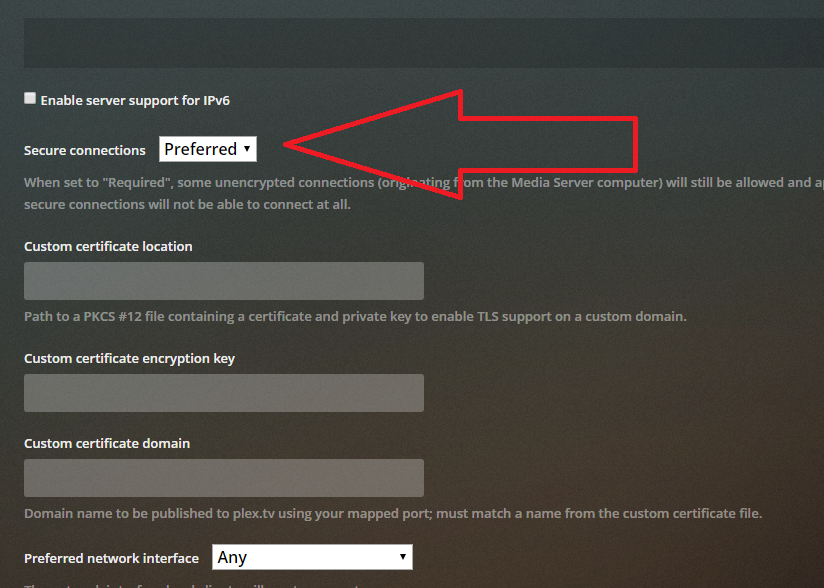

Oh. Actually, it looks like you have the security setting on your PMS set to disabled.

Believe it or not, I was trying to get this to work on an xbox one, and this fixed it because SSL wasnt working. I’ll go ahead and turn it back on and provide new logs.
I’ve been playing around with a lot of settings because i posted over a month ago and didnt get any action on the post, so I’ve been going through absolutely everything. It slipped my mind about turning off the secure connections. I assure you the issue is still present regardless of that item. I will go ahead and upgrade Rustic, turn on secure connections and get new logs for you.
The issue might have been with the XBox not being able to make a secured connection. Your server itself should be fine.

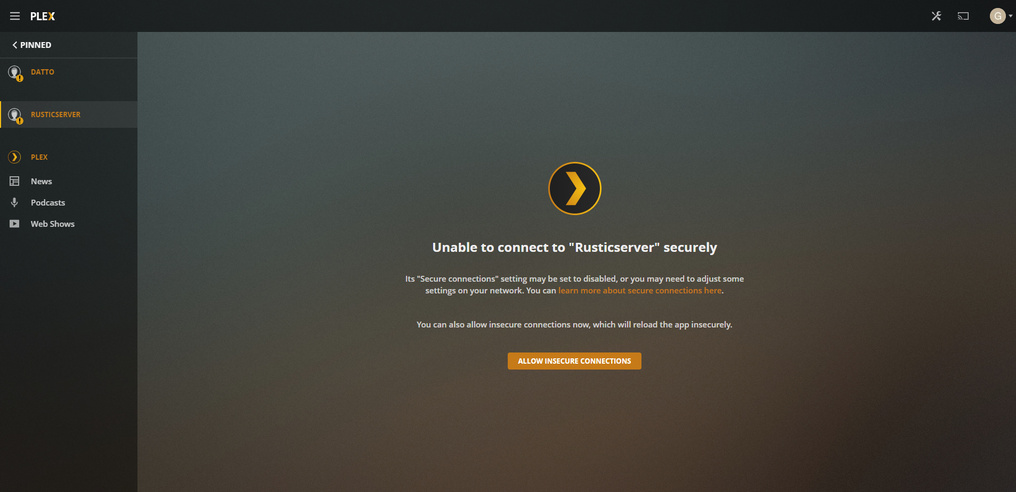

The issue is for all devices, not just the xbox. For any and every client. Here’s an attachment from Plex Web. Note: I just updated both Plex Servers to 1.16.6.1592. I will post logs in a few minutes as they just came back up, and i know yall want 5 minutes on the logs.
I meant when you had your initial issue. Now, you have that setting disabled, so it’s not possible to create a secured connection. Turn that setting back on. Restart PMS, try again.

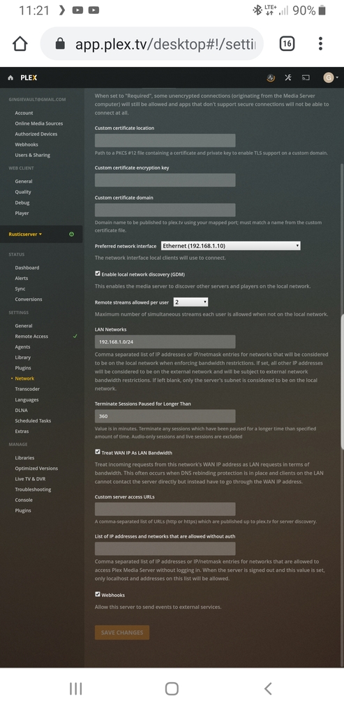

back to square one. I haven’t been able to sync any items for the past week, and now SSL quit working again on my main server, second server seems to be fine for the time being. I’m on the latest version of server for windows, version 1.17.0.1841. i initially updated from 1.16 because Sync wasn’t working, but now SSL isnt working either. Also here’s proof that i have secure connections turned on.

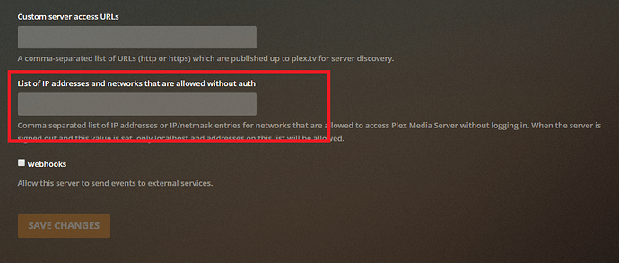

Scroll further down. Do you have this box filled?
Nothing in that box.
Why do you know SSL isn’t working? From your screenshots, I see the green lock icon next to your server. This indicates that Web is using a secured connection so it is working.
