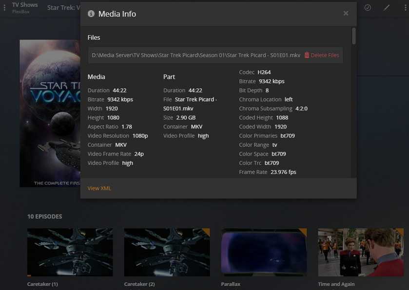

The metadata used to work fine but at some point recently this show started misreporting as the first season of star trek voyager instead of star trek picard. I sanitized the file structure to the recommended names in an effort to fix the problem but have not had any success. Here is a screenshot of the current file structure.
I’ve also removed and re-added it several times in an effort to fix the issue.
Thanks in advance for any help

Thanks for the reply. I gave that a shot but it still appears to be broken. I renamed all the eps adding the dash and moved the whole picard folder out, rescanned library to remove, moved it back, rescanned library to add it back. Still had the same result with it changing it to voyager.

I do also have Discovery this was a great idea of something to try. Unfortunately it still didn’t work. I removed both Discovery and Picard folders to another location, did the full plex dance. I moved only Picard back did a scan and it still mislabels it as Voyager. I do not have any other Star Trek TV show content in there at this point.
