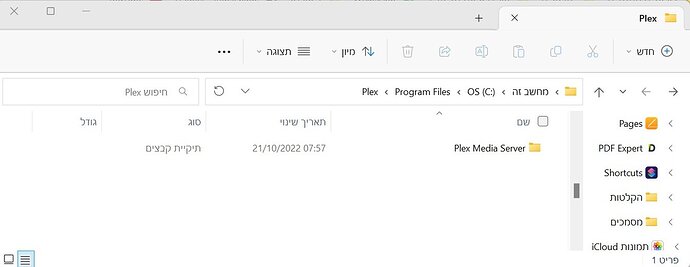

a shortcut to Plex Media Server.exe in that very folder above.
where is the Plex Media Server.exe is located so i can create a shortcut?
In that very folder above
is this the right directory for the shortcut?
I can’t tell you. I think it might be not correct, because it is global (i.e. for all Windows user accounts), while Plex server must only run inside one Windows user account.
Please use the startup methods described in my link above.
i am the only user on this PC. the file is in the startup folder and it’s on but still, Start Plex Media Server al Login is not checked.
Please reboot your computer and look again after that.
Keep in mind that autostart apps are started with a 10 second delay by default.
