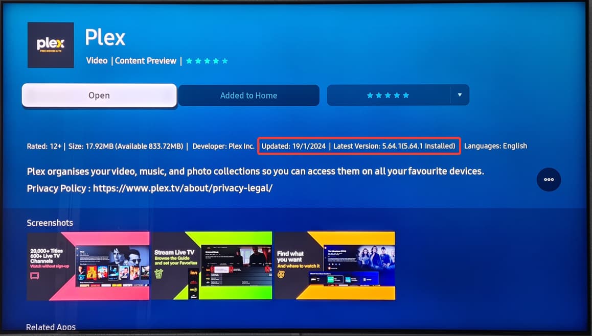

Hi, I have a Samsung QN95 ( QE65QN95AAT).
But according to the TV app manager the version 5.64.1 is up to date:
