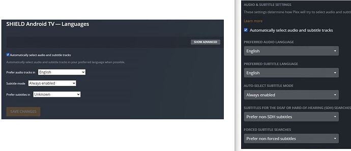

Why do you have to Prefer subtitles in “Unknown” instead of “English” to get PMS to see and use them?
These are my current settings - have I got something set incorrectly?

The server is selecting the file named subtitle.srt because you have “Unknown” configured in the Languages settings. The subtitles without a language identifier are considered unknown, so technically, it’s doing exactly what you asked it to…
Once you have all of your subtitles renamed with the language, all of your settings should be set to English, and it should work as expected.
You will likely have to refresh metadata for the show for the subtitles to show up and work properly.
That seems to have worked a treat by adding “.eng” before “.srt”.
