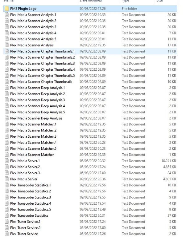

Not sure which file I should attach for the Server Log?
Attach the entire ZIP file (Settings → Troubleshooting → Download Logs).
Thanks!
I have attached the server log.
This was done from my computer. Not sure if this should be done from the Nvidia, and if so, how to do that?
Plex Media Server Logs_2022-08-09_21-28-13.zip (2.0 MB)
