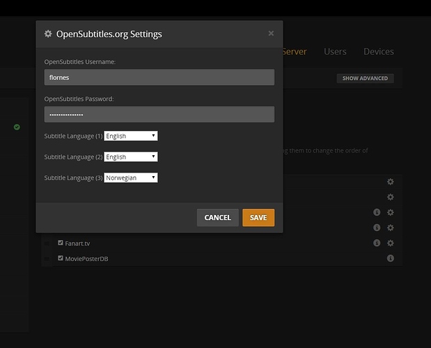

I have OpenSubtitles.org (agent) logged in and on top in the agent selection.

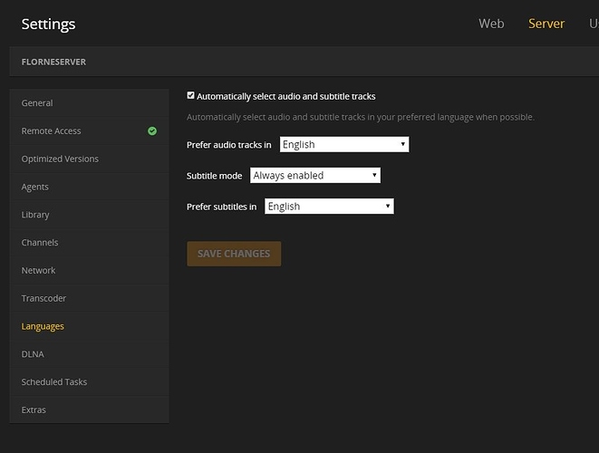

My PMS is in english, and the prefered subtitles are english. In my server settings I have chosen subtitles as “always on”
I dont get any subtitles on anything. How can I fix this? I would like to force subtitles, always, even if the movie is in english, I still want english subtitles.

There was an old bug where if you had more than 1 language selected, the plugin wouldn’t work. I don’t know if that was ever fixed. So try removing the selections for (2) and (3), then refresh a few movies to see if it worked. If so, refresh the entire library.
Thanks for the reply, but this did not solve the problem unfortunately. I have disabled (2) and (3) ive refreshed many single movies, multiple times with no change, I also did a library refresh and analyze just in case, but still no subs.
