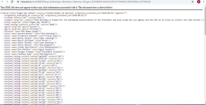

Can you successfully open this URL in from your server or PC ?
https://meta.plex.tv/m/6189022?lang=en&ratings=1&reviews=1&extras=1,
i did see this and a lot more code
