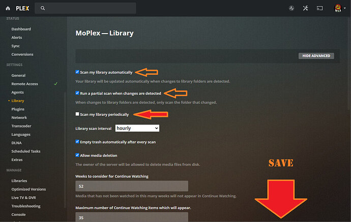

This will ‘streamline’ the scanning process as much as possible:
Set this way, when you add new media - only the new media is scanned - automatically. There isn’t any need to manually scan at all, but Plex will, if told to do so, scan the libraries during maintenance (Scheduled Tasks).
The real scan-saver is having ALL your movies in unique folders. TV Shows are already mostly in folders, but ‘Partial Scan’ cures most of those scans.
DO NOT Empty Trash Automatically, if there is any danger of storage being asleep when Plex starts maintenance. Your entire library could be removed from the database… don’t want that.
