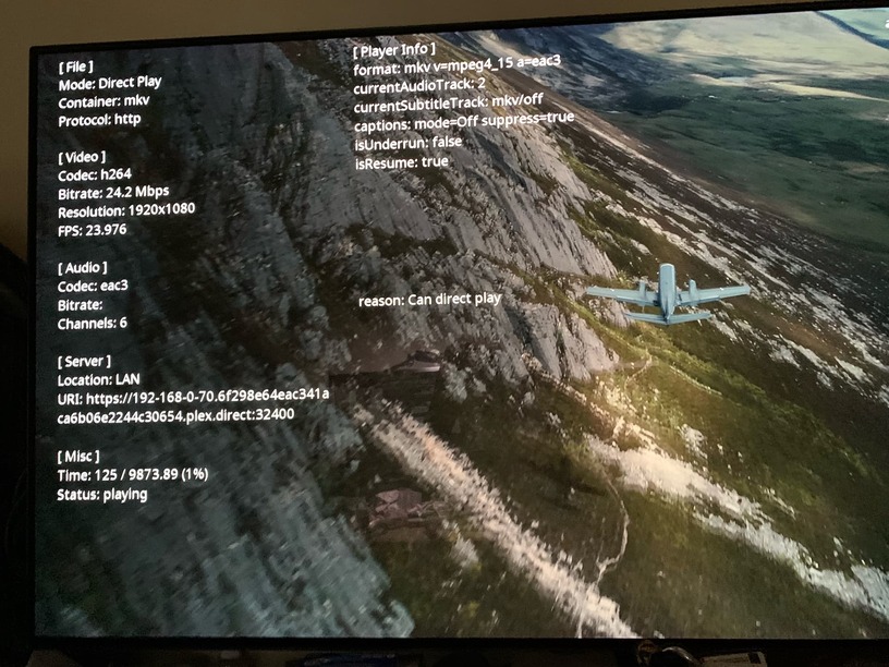

That video worked fine, no issues. However, on my Plex, that video said it was “7.1 TRUEHD” audio. The files I can’t load say “5.1 EAC” audio.

I downloaded and was able to run all of the Dolby samples with no issue. I didn’t see the other two samples until I came back up here, but can try them again tomorrow if needed. I also will have to figure out how to get a sample video made too. (It’s not just one video, but all of my VIDEO 1080p (HEVC Main 10) AUDIO English (EAC3 5.1) files)
What I did for now, is I ran the 4 dolby videos, one of them almost entirely. Then I ran one of my other videos that don’t work until it timed out. I waited a few minutes, and then saved my logs. I hope this helps with the troubleshooting.

This directplay, ARMv8 NAS , DirectPlay
