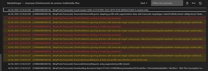

Hello, I also just redid the test on my side, with the video “LG Colors of Journey HDR 4K Demo”. Here are also the logs.
Plex Media Server Logs_2025-07-30_12-03-49.zip (4.0 MB)
When I launch a movie, I have this on the console:
Like EZTutty, I also have the message “failed setup for format vaapi: hwaccel initialisation returned error”
