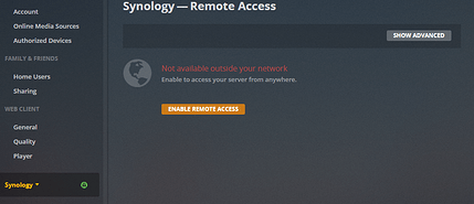

New development. I was looking at my NAS settings and Unchecked (2) boxes under the network (picture 1) and resigned into plex. Plex port 3200 allowed me to claim my server. I went into the remote settings and checked the manual port button and retry button (picture 2). It took me to a second window to enable remote access (picture 3) and when I click the button it will go green for 2 seconds and then right back to it not being enabled.
That’s good to know. I finally got it working again within my network by by unchecking those boxes but I am still having issues with outside the network. When click the activate outside the external network, it activated then deactivates right away.

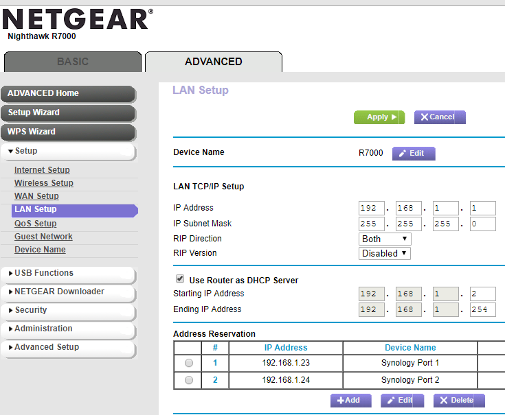

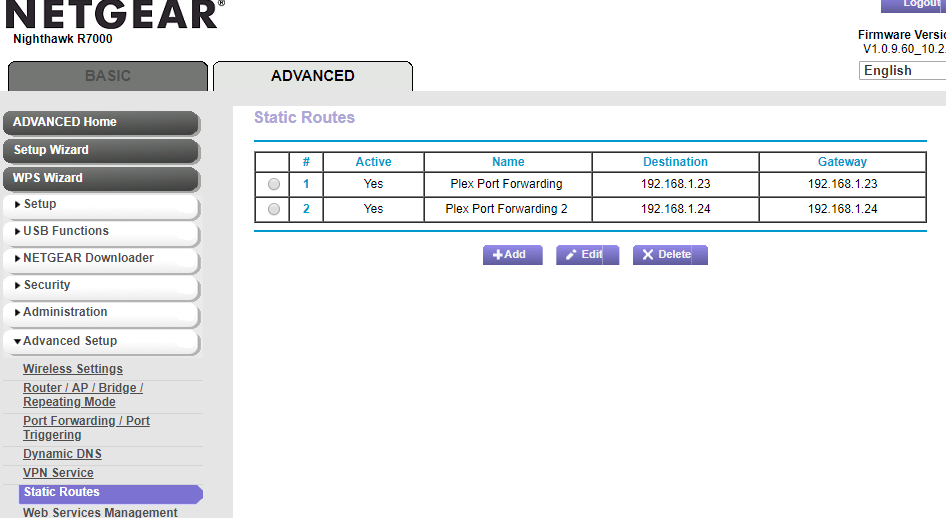

I am still having issues with the remote access part. Every time I click enable remote access, it will go green then back to red. Is there a setting that I missed? Do i need to change anything on my modem? I have included a image of all of my router settings. I currently have a netgear R7000 router.
I went through all the steps you indicated and I still cant get the external access to work. Any other advice?
No I am not using a VPN.
My NAS system is connected to my router and my router connects to ISP modem. I have include a couple of images of the ISP information. Let me know if there is any other settings you need to look at.
I finally got it to work. By disabling the Nat on either of the devices actually caused a big problem and I had to reset both the modem and the router.
I ended up moving the NAS to the modem and created the port forwarding as instructed earlier by you and then reconnected the router to the modem and it worked.
