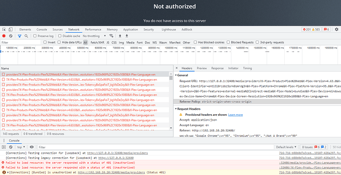

This is what I see on dev tools for the browser:
I am not using DNS name, only IP when using a browser. – I feel like the Synology is setup properly. All other functions work. Synology Network is configured with static values, not DHCP or dynamic. Layer 3 switch with multiple VLANs.
Looking at the log file, I do not see any DNS errors or quickconnect.to errors.
The only 401 errors I can find in the log file. Source IP below is the client:

I thought maybe I have a plug-in error, but I would not think that would cause an authorization error and they are returning 200.
Honestly, not sure what else to try. I’ve looked into cross-origin errors. I’ve tried the prebuilt Plex package from the Synology Package Center. I’ve read all the posts I can find.
