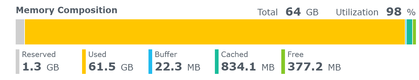

I would appreciate some assistance finding my recent high RAM utilization. I have 64GB installed, and in the past I would find the majority of it allocated to cache. This made sense, it was using RAM to cache files to improve performance. now, after a few days, it all is used. There must be a leak somewhere as now I see it all tagged as “used”

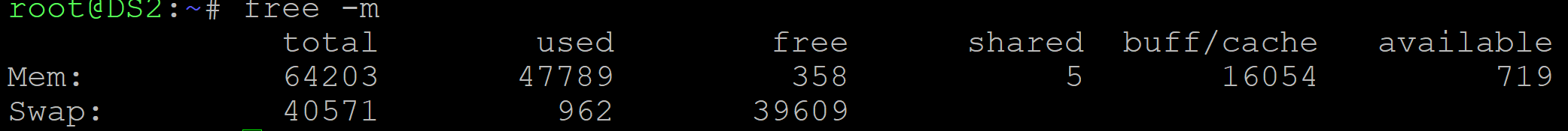

I am not sure it is PLEX to be honest, at free and top don’t help me see its usage
top shows a few processes all using .2% or less each
not a docker app
What can use memory and not show it in “top”? Maybe a driver w a memory leak?
only way I found so far to free it up is a NAS restart.

None of that shocked me as top showed none of those processes using that much RAM. but plex does include video drivers, for hw transcode, that has been seeing changes lately and other problems… thus I was postulating maybe this is a place you can have a memory leak and not see it assigned to anything in top, while still being “used”
There is one way to properly see what’s happening and that’s get in at the command line and run top.
top will let us look at the RSS (Resident) memory in use by every program
hmmm Well it has been two days and my memory “used” seems to have stabilized. fortunate from the perspective that nothing seems broken, but I sure would have likes to learn what can lead to memory that is “used” but doesn’t appear tied to a process in “top.”
