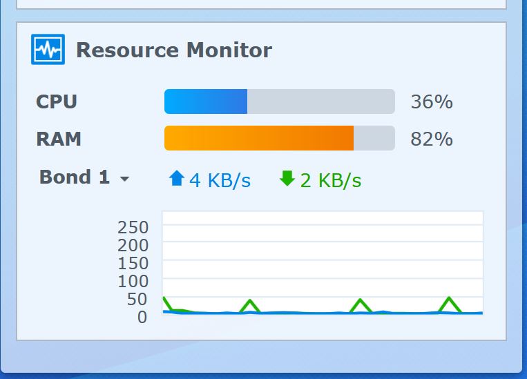

I have a Synology DS918 with the standard RAM of (I believe) 4 GB, I haven’t upgraded. At some point in the past I tried to use the RAM as a temporary directory but after seeing no difference I removed that from the PLEX settings by blanking it out.
But months later I’m noticing the RAM is being utilized by PLEX so much that Synology is giving me warnings, and I’m not even sure these are related. If anyone can give me a hint as to what else I need to change I’d appreciate it. Stopping the PLEX app on the server and starting it again removes all the RAM storage for a while. Also, this is a problem even when PLEX isn’t currently being used to watch anything.

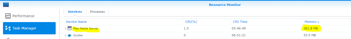

Thanks for the reply. No, the image I show is sorted by memory usage and the next two apps shown running are far less. I guess the combination of all the rest of the apps is the 32%
When I took those screen shots I’d checked and Plex wasn’t doing anything. As I mentioned I’ve caught it in this situation multiple times (Plex using nearly all the RAM and doing nothing) which makes me think there’s a setting I need to check.

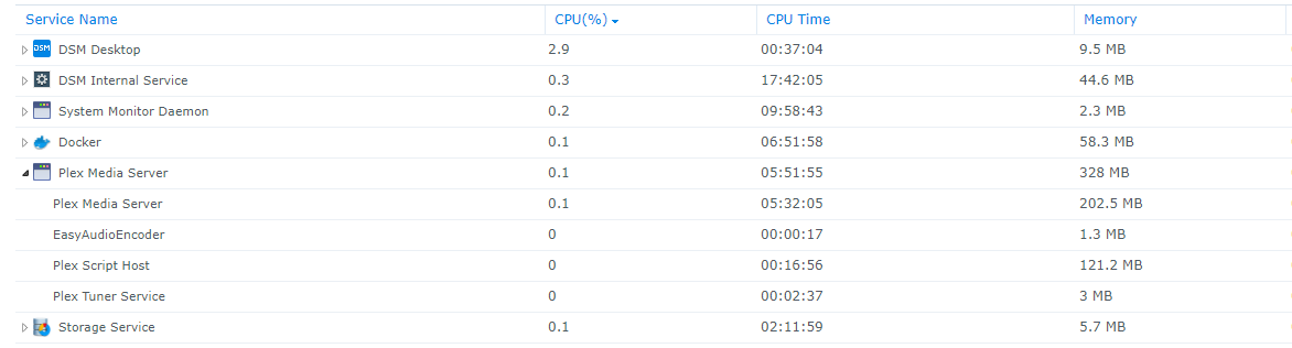

I will screenshot the full list of what is running and post it here tonight once I get home from work. There are some additional things, but as you can see in the original post Plex is by far the biggest RAM hog and it hasn’t always been this way.
Thanks for helping.
Here’s an update of screenshots showing all the apps running.

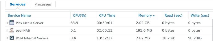

I have 1 direct play and 1 direct stream going on when I took this screenshot:
On a DS1019+ with 8 GB of ram.

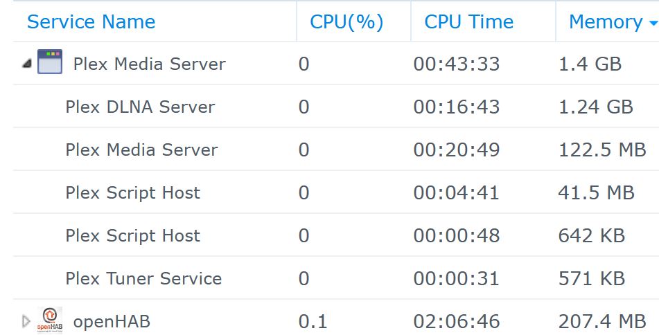

One last thing, if you will, could you click on the triangle next to the Plex Media Server entry to show all the sub-components running as such:
Thanks.
Right now the RAM used is at 77%. Not showing critical as it was earlier but this is what shows running when I open the PMS entry.
Turn off the DLNA server . It’s a known leak which engineering cannot find.
All new installations default to OFF
Okay, that definitely made a huge difference! Thanks again!!!
