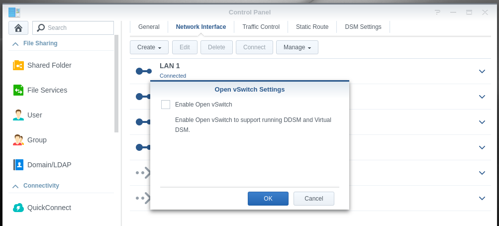

Is there a particular reason to have the virtual switch active? Are you running a VM?
You have only one ethernet adapter defined and in use.
I uninstalled the Synology vm manager has part of my original troubleshooting steps. link to what I’m talk about below. I did notice that after the uninstall the ovs interfaces did not get removed.
Maybe I need to look into removing the vswitch.
So to be clear virtual machine manager was installed it has been uninstalled since I’ve engaged on this form but maybe it takes a little more get that fully removed?
Thoughts?
If I happen to come up with anything I will post here.
https://www.synology.com/en-us/dsm/feature/virtual_machine_manager
Do you run multiple PMS instances on that Synology?
If not, there is little to be gained by putting it in a VM. Most Synology systems doesn’t have enough CPU power as it is (except the xeon machines).
I’m asking because of the added complexities with Synology’s VM’s. Running native is actually better.
Turning off the OVS is easy:
To be clear the Plex install has always been native
I have removed the Vswitch removed the Plex package, deleted the sheared folder and the user. At this point, I reinstall the latest Plex version. No Change log attached.
