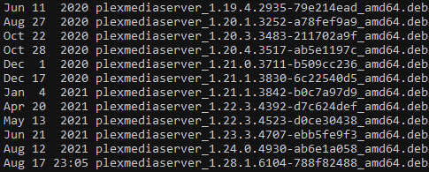

I have a folder where I download Plex releases whenever I update.
This is that folder now:
All versions above 1.19 are attempts to upgrade, but with the same result as now.
