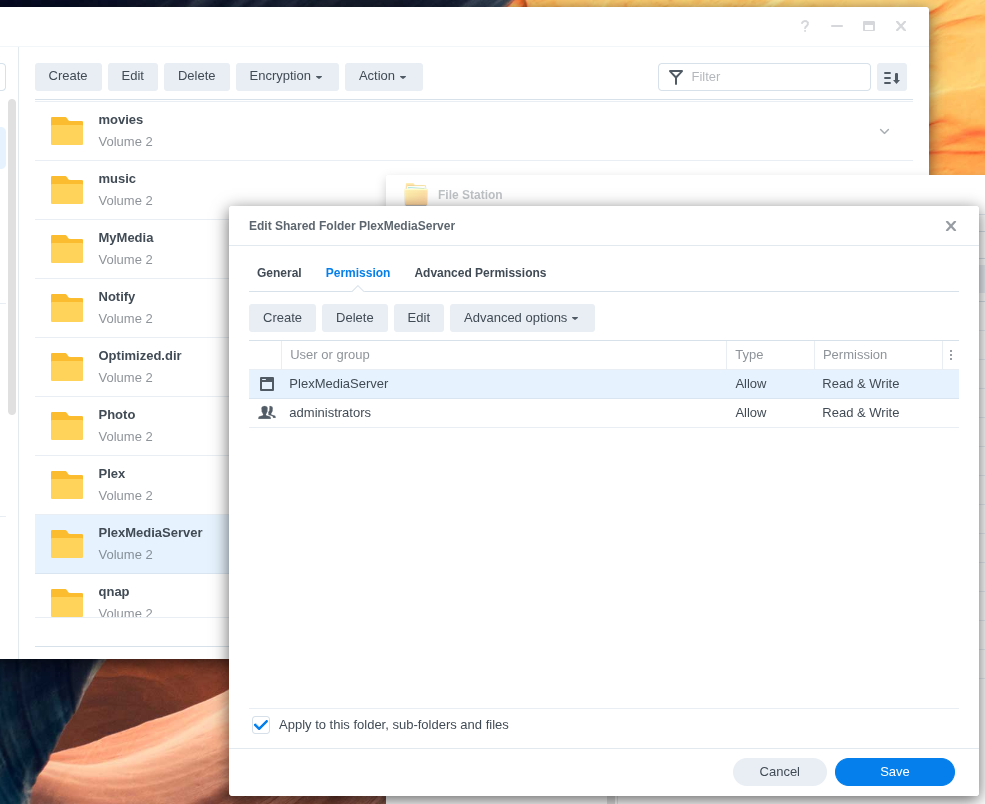

In addition to the above shown task, the Shared Folder permissions must also be set:
PlexMediaServerPermissions tabSystem Internal Users (left side dropdown)PlexMediaServer has R/W (Read/Write) permissionPlexMediaServer has Read/Write permissionsApply to this folder, sub-folders, and filesPlease confirm there is NO MEDIA (movies, episodes, or music) *ANYWHERE in the PlexMediaServer shared folder .
There don’t appear to be, no. I have checked the top level of the AppData folder and many subfolders at random and there is no media.
This (above) is the sole parameter I needed to check. Everything else was already checked/unchecked. Now saving, quite slowly as I believe I have internal network speed issues (which an entirely different support thread by my ISP is trying to sort out.)
Those permissions are being applied directly to the files on the host.
There is no network (LAN) involvement after clicking SAVE.
The page will refresh when all work is complete.
On PMS installations with a lot of media indexed, it will take a fair amount of time. (takes over 20 minutes for me even with my big RAID array)
