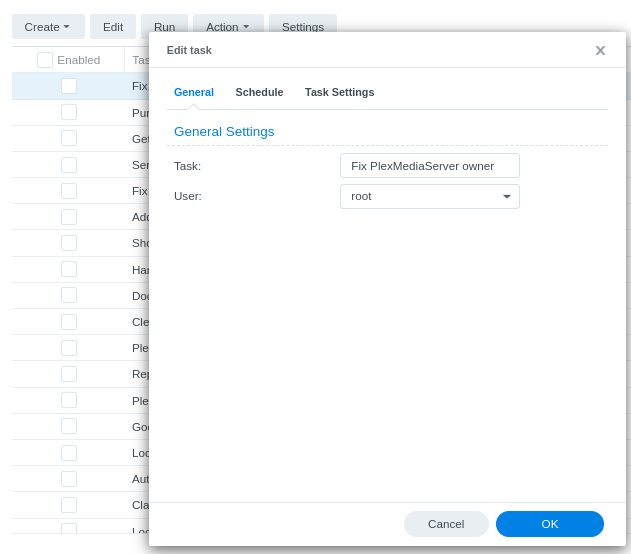

In the event anything is awry in the shared folder (as viewed using FileStation),
an easy method to confirm all file system ownership and permissions are correct is to create and run this task in Task Scheduler.
Create the task in Task Scheduler → User-defined Script
- Username to run as: root
- Email you the results:
- Task settings (script) contents:
#!/bin/sh
cd /var/packages/PlexMediaServer/shares/PlexMediaServer
chown -R PlexMediaServer:PlexMediaServer AppData &
find AppData -type d -exec chmod 755 {} \; &
find AppData -type f -exec chmod 644 {} \; &
wait
Run the task
- Run the task
- Wait for it to send you results in your email
- (re) Start PMS.
