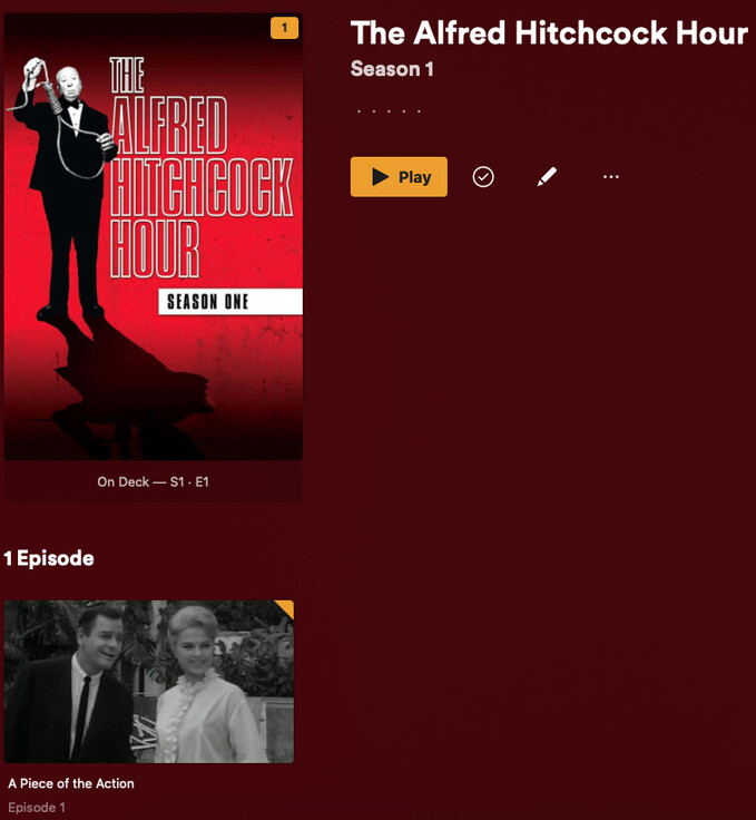

Which scanner and agent are you using for your library? If using Plex TV Series, you should be able to name your files and directory structure something like the following:
test_tv/     <--- TV series library points here (name not important)
└── The Alfred Hitchcock Hour (1962)
    ├── Season 01
    │   └── The Alfred Hitchcock Hour (1962) - S01E01.mkv
    ├── Season 02
    │   └── The Alfred Hitchcock Hour (1962) - S02E01.mkv
    └── Season 03
        └── The Alfred Hitchcock Hour (1962) - S03E01.mkv
This results in correct metadata being pulled for “The Alfred Hitchcock Hour” seasons 1, 2, and 3. From season 1:
