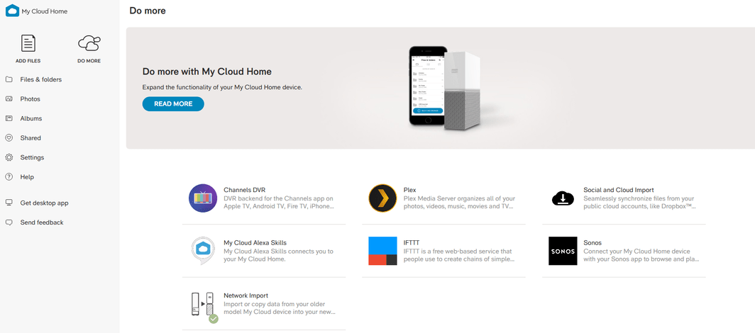

If you want to disable the Plex server from within the My Cloud Home, you need to go on the website at https://home.mycloud.com - click “Do More,” select “Plex” and click disable.
You can also do this from within the My Cloud mobile app.
