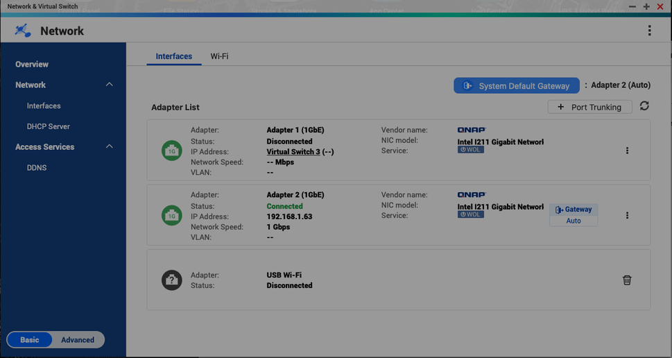

  1. The IP is now static ? And you restarted the QNAP?
  2. How many adapters are in use? Just one?
everything I know about how it all works is telling me you have a connectivity problem between the first hop and upstream.
My reasoning is:
  1. If the adapter were still going up & down, we’d see the RTM_LINK messages. We don’t.
  2. Therefore, whatever the QNAP is plugged into is apparently electrically intact (loose connectors & damaged cables to happen)
Are you comfortable opening up a SSH session to the QNAP and having it run a steady ping to look for dropouts? If so, please start a steady ping to google. We’re looking for anything to drop out (missed PING replies).
Also, I think you really should optimize that database. The number of “SLOW QUERY” is disturbing. I know the N3150 isn’t a fast CPU but it still should be faster than that.
  1. Yes, it is now static and was restarted: 192.168.1.63
  2. One adaptor is in use
The NAS is connected directly to my modem/router by a 1m standard cable of unknown origin and probably quite old. I have just swapped it out for a brand new 1m Cat6 cable

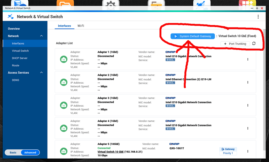

Go back into “Network & Virtual Switch”. See how your Default Gateway is “Auto” ?
For some screwy reason, QNAP seems to work better if:
  1. The default (in auto mode) is the first adapter
    -or-
  2. We hard set & lock the specific adapter.
Please look at what I’ve done.
not sure how significant this is, but I was only able to select the adaptor. I don’t have virtual switch (should I?).
The existence or not of a Virtual Switch is dependent on whether you have containers or VMs defined. If you had either, you would have a Virtual Switch (brings those different software subnets together at the adapter like a router).
