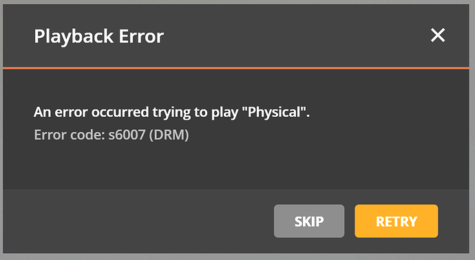

So this Easter I decided to try this Tidal feature. It was working at the start of the week, but over time some songs have started stopping with a DRM related error. This seems to follow the song itself as opposed to the platform, which is what I would expect if I had any DRM issues. I have tried re-linking my tidal account and it doesn’t seem to solve the problem. Has anybody else come across this over the last week?

It’s getting worse on my end. Like I wrote it initially happened now and then for some songs and would stick around once it happened. Now everything throws this error. Gotta say I’m about to just give up using Plex for music as this is honestly defeats the entire purpose of having a Tidal integration and I may as well just use their app exclusively. It’s a shame that I loose out on my lossless quality files, but this is just to annoying to deal with :frowning:

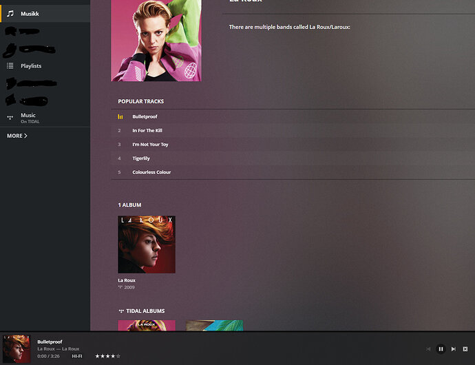

And then I had my daily quota of two Tidal tracks and now we are ■■■■■■ again. This time with the situation where no error is reported or audio heard yet playback appears to be happening:
Also I tried downloading the client logs, but I can’t find any sort of reference there to playback of these tracks (Bulletproof and In For The Kill worked a moment ago) being stared :frowning:

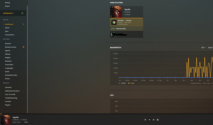

I’m using www.plex.tv, but the point is that this is happening across all my devices. And yes I have tried re-linking the account. It didn’t seem to do much. One thing I did notice is that right now all the issues seem to be related to Tidal tracks that I have added to my own music library. And they seem to cause problems far more often if I try to play them back from said library as opposed to via the Tidal category. Also while looking at the dashboard while gathering the logs I noticed this:
From the image it seems that my server thinks it’s playing back the entire track, but even though I’m on the same local network and should have a direct connection nothing is sent my way. Presumably due to the DRM error seen in the logs i attached earlier. The only thing I can think of here is that my Plex server is running on a virtual machine and as such connected to its own virtual network provided by the host. This shouldn’t matter though as everything is routed correctly both on the virtual machine and the virtual machine host. However I don’t know how the DRM feature incorporated in Plex works and if this routing between different subnets can cause any trouble with verifying my right to playback Tidal tracks.

Also, because the dashboard shows local playback, I would think your VM network is configured correctly. That shouldn’t be the problem (I wouldn’t think, anyway).
