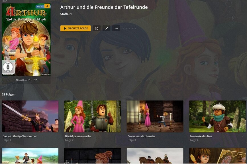

Almost giving up… Was showing this way after first adding to Plex. Removed it. Cleared trash, cleaned bundles, optimized database and re-added series again. The same. Tried again. No change.
tvdb is showing all and everything in German incl. all episode titles and description, but Plesk shows only one episode in German incl. German description, almost all other episodes with French title and no description and some without anything.

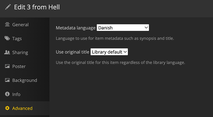

Edit the show as a whole ( not the season or individual episodes) . look under advanced and see what metadata language is set for it.

Thanks. Meta Language is German.
Use original title: Library default is set.

Tested it yesterday and today. No change. Still French. Tried to unmatch and match again. No change. When matching it only ONE series is showing. Not the French one.
I am using the correct id: {tvdb-360990} (Arthur und die Freunde der Tafelrunde - TheTVDB.com)
You are right. Plex is using the French version as only 49 episodes get a (French) title. The “regular” version has 52 episodes.
