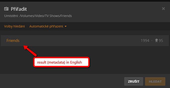

I created a new tv shows library (in czech language) on the PLEX server 1.1.0.2611 . I use “TheTVDB” agent. My tv shows (folders and files) are correctly named (in english language). If the original name of the TV series is same in czech and english language, such as “Star Trek”, metadata are downloaded in the czech language (it’s okay). If the original name is different in czech and english language, such as “Friends” in english vs. “Přátelé” in czech language, metadata are downloaded in the english language. Previously I used KODI, where all metadata has been downloaded properly in czech language.

Unfortunately, the problem is not solved.
Example:
I have English file names and plex scanner has a problem with it (no problem in KODI).
Confirmed, I have to use my local language in the file names when I want localized metadata in Plex.
Sorry, there is only this solution.
Changing file names for a whole series is easy though, if you use software like Filebot
