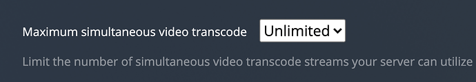

I have lifetime Plex Pass. I have a new user/friend added and he constantly gets the error “to many streams”. He has never actually watched anything as the error began instantly. We created a new user account and that worked for a day or two but the error came back. He is the only user on my server that has this issue. I CAN PROVIDE SERVER LOGS (-_•) if anyone at PLEX would like them. I would like this error fixed as I am sure others I have found In the forums with the same issue would also like it fixed.
This is the first and only issue I have ever had with PLEX. Making PLEX the best application I have ever used on any device and on any O.S. going back to my Texas Instruments Ti99 and Zenith Data systems 16MHz.
so you don’t have either of these set to something that would affect it?
