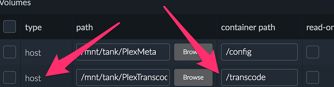

Starting with 1.5.1, if the transcoder is working with either the AC3 (Dolby Digital), EAC3 (Dolby Digital+), or TrueHD, then the process can fail if the /transcode is really located on a network share. The transcoder requires certain filesystem capabilities to work which are typically not available on shares.
This is most relevant for FreeNAS Corral users because any volumes you create are network shares. If you examine your docker config and find that /transcode is located on the host, such as seen below, then you need to change this:
The easiest solution is to delete the volume and then it will persist in the VM. Check the checkbox next to the volume and then hit the trash button. Finally save the container.
After this you will see the /transcode mount existing, but it will be in the VM instead.
Lastly, since FreeNAS does NOT recreate the container correctly when you edit it, it completely bypasses the initial setup scripts that run in the container the first time. One of these steps is to correct the permissions of the /transcode directory. So click on the Console button for your container and in the new browser window type chown -R plex:plex /transcode.

Thanks for the solution! Worked for me!

Appears that the new transcoder implementation does not work with docker at all?
I tried a third option, where the transcode folder is in the same general container aufs overlay.
I also tried using an implicit volume mapping (=3nd screenshot from 1st post) and an explicit volume mapping (=1st screenshot from 1st post). All three variations result in data beeing written into the transcode folder with proper ownership and permissions, but can't be used by the server.
Example mapping for an explicit volume mount (1st screenshot from 1st post) looks like this in docker inspect:
"Source": "/opt/docker/plex/transcode",
"Destination": "/transcode",
"Mode": "rw",
"RW": true,
"Propagation": "rprivate"
The "vm" mount point in the 3rd screenshot from 1st post is an implicit volume mapping. It applies if a volume is declared in the Dockerfile, but no volume mapping is provided during container creation.
With docker inspect it translates to (random generated id will differ on each container):
"Name": "1d78465e2b45de609d0454cff7521507898bfb445d3a397d114077003c5cb110",
"Source": "/var/lib/docker/volumes/1d78465e2b45de609d044cff7521507898bfb445d3a397d114077003c5cb110/_data",
"Driver": "local",
"Mode": "",
"RW": true,
"Propagation": ""
In order to bypass implicit volume mapping of the /transcode folder, I created a /test folder inside the container, chowned it to the plex user:group and changed the path in the transcoder settings to /test.
Thus, data in /test should have been inside the general container overlay, rather then in an implicit volume (like shown above).
But this doesn't work either, even though I can see the files are created in /test and have the expected ownership and permissions.
