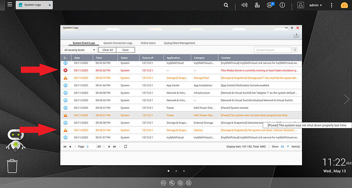

However, my Qnap logs show the following things that happen (screen):
As you can see, somehow, the File System becomes corrupted, then a Power warning, then Plex eventually crashes. I have verified that the power did not go out during this time. The “Storage Pool has reached…” alert is known and has been that way for a bit. It wasn’t only triggered during this event.
Contacting Qnap support, they said app crashing can cause the file system to become corrupted (not clean – the fix is to run a File System Test which has resulted in always a Success. So I do not understand why it’s being “corrupted” in the first place.) They also mention that the Power warning could also be caused by apps crashing and causing the Qnap to trigger that message.
However, when I try to dig into my Plex Server logs (obtained from Downloading the logs in the Plex Web app) there are no logs for this timeframe, only up to about 1-2 hours before the crash.
Qnap support was able to find the following errors in the filesystem (screen):
It seems like an issue w/ the Plex Transcoder failing. I have verified that a Plex remote player was streaming during that time. However, I do not know how to prevent this error from happening or why it causes the whole Plex server to crash.
