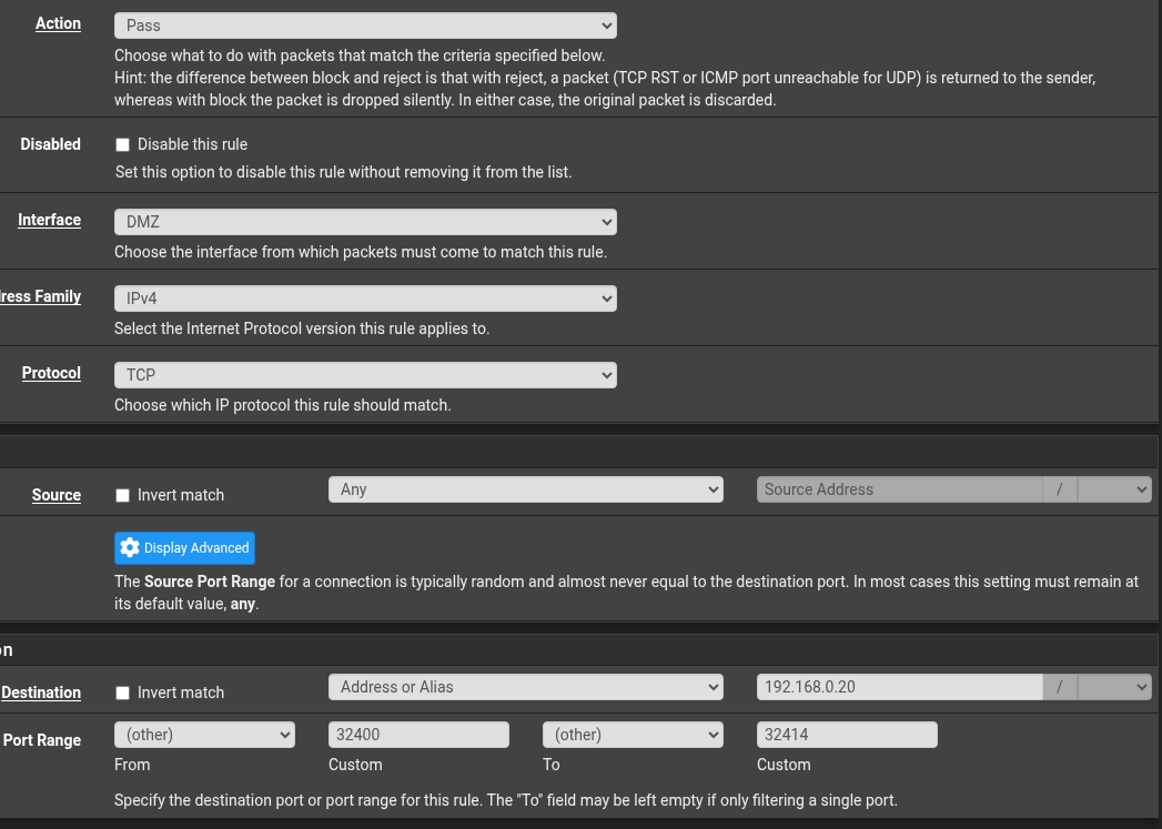

Given PfSense can be very strict, which is why I use it,
Do you have any IP address-specific rules for Plex remote access ?
Asking because:
  1. Multiple subnets will cause plex.direct to hairpin turn in PfSense (NAT Reflection required) – unless mitigated
  2. One form of mitigation is to have specific rule which passes the plex.tv servers pool of possible IPs
  3. Another is to have Plex DNS rebinding allowed in the DNS resolver
  • Custom options:
private-domain: "plex.direct"
  1. Firewall PASS rules to 32400 for all your pubsub servers
    ( listed under <MyPlex> in your logs
Asking this because:
  1. Chromes, on a different subnet → REMOTE
  2. Remote streaming rules apply
  3. Pubsub / Plex.tv must see Remote Access reachable (valid)

I’ve been using Chrome for ages and started with PfSense in 2017.
My Chrome machine is on the LAN interface (workstation) with the server
  • 192.168.0.0/24
TVs are on the DMZ interface (192.168.2.0/24)
Plex app on TVs is the only thing to cross into LAN
I don’t use any proxy or HA software. ( I’m not a public/commercial server )
