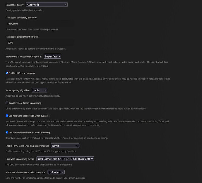

Server is running in an ubuntu lxc on proxmox. Attaching Server Media Logs that show the media direct playing then gets stuck loading when i try to transcode it to 1080p. I have verified that transcoder settings are set as they should. Just changed transcode temp directory last night to /dev/shm/ in attempts to help with this since I saw in some threads that it could be due to default transcode temp directory filling up and not clearing in time. Any assistance would greatly be appreciated.

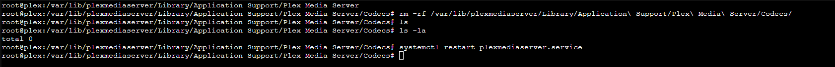

Removed all contents from /var/lib/plexmediaserver/Library/Application Support/Plex Media Server/Codecs/1c96867-c7c51eae1050ee8a09ae8dc1-linux-x86_64
Restarted PMS. Same error/issue
Please let me know if i delete the correct contents.
In Linux, to remove a directory and it’s contents:
rm -rf directory_name_or_wildcard
Got it. Thanks. Ran rm -rf /var/lib/plexmediaserver/Library/Application Support/Plex Media Server/Codecs/
Took a snapshot of the ct before in case I did it for the wrong directory. Restarted pms and forced transcode again. Same error.
