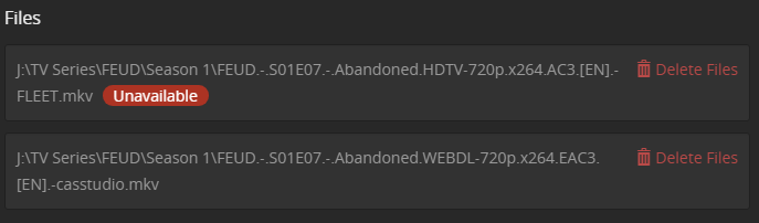

Looking at your path, Try and move “FEUD” to some where else outside that library “TV series”. Then delete the total series in your library if still there. Then update library and re add Feud back to Tv series in your storage. Refresh and you should only have one copy.

It is a very odd issue indeed!! Initially i thought it was content on my stablebit drive, but it isnt limited to just stablebit! I wonder if it is just windows servers? havent seen clarification from the other posts.
Happens with Movies and TV series, plex knows they arent there but wont clear them
The above image is after a update library, and “empty trash” is enabled in the settings
