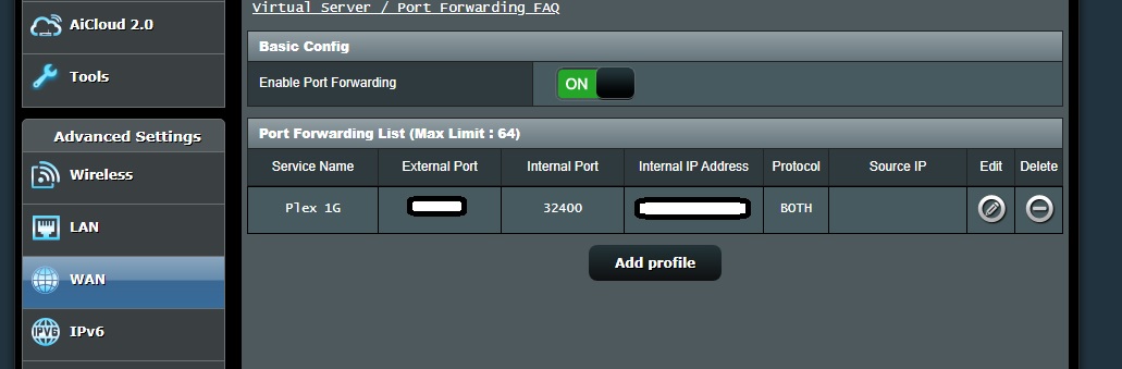

Did you put the new modem in bridge mode? If not you have to do that. Then double-check that your port forwarding is setup in the virtual port forwarding section with the correct IP address of your server. I know you said you already did that but make sure it’s the same after changing the modem to bridge mode.

Port Forwarding that 68 is a breeze (at least on the latest Merlin):
I have a non-standard port (in the valid range) forwarded in the router and manually specified in Plex.

I’m like you - only 10X worse (No Network Skills to speak of) - but I do know if you don’t get a port forwarded in your router and Plex you’re going nowhere.
