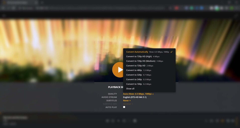

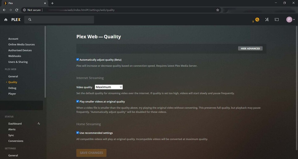

i can no longer direct play ANYHTING on the web player
i can’t find anything that would limit this, or suggest I can’t play the original file
Turn off auto adjust quality.
that just confused htings even more haha
now i have no option to change the stream at all, but does seem to be full quality
although apparently it still wants to transcode the audio :-/
No issue using the plex app on my pc though, just plex web at the moment
Of course. Web browsers are very limited. You’ll get AAC & Opus to direct play in Chrome. Everything else will transcode.
