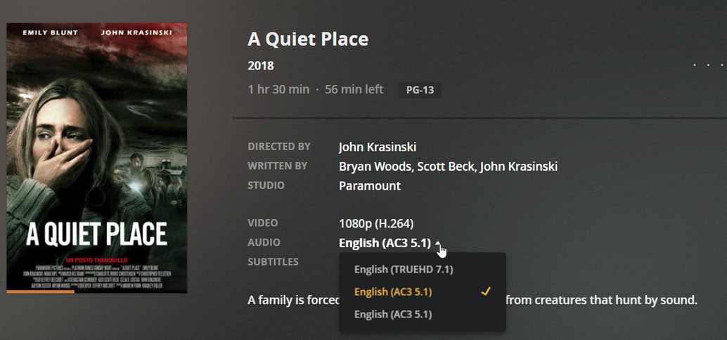

After uploading a MKV Blueray to my Plex media folder, it won’t play if I leave the default audio track set to TrueHD 7.1. It won’t play any player device in my house (Windows 10, Vizio, TCL, or Roku devices). I simply edit the movie and select ANY other audio format within Plex and then it streams just fine.

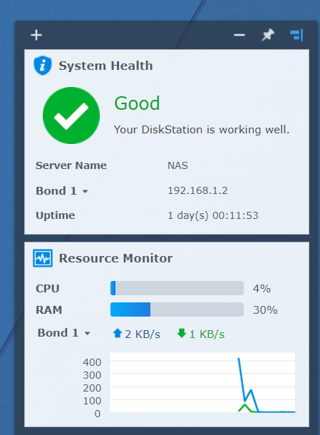

16GB… and 99% of the time the CPU is practically sleeping…
2019-01-23%2019_23_15-Microsoft%20Edge
Baffling no?? lol. This is so strange!
