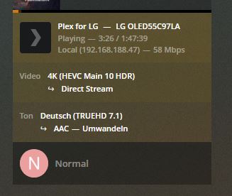

Sounds like when you choose TrueHD audio, which will transcode, it results in the video also transcoding. Enabling subtitles can cause that. Haven’t ran across other reasons. You should be able to transcode audio and still direct stream the video.
First step is to verify that is what is happening.
Play your video with the AC3 audio track. What is shown in the Dashboard (Plex Web -> Activity -> Dashboard)? Are both the audio & video direct playing? You may need to click the gold, rectangular icon on the right to expand the view.
Then play the video with TrueHD audio selected. What does the Dashboard show?
FYI, just doubled checked with my B7 OLED. I can play an HDR10 movie with TrueHD audio and no subtitles. The video direct streams, the audio transcodes to AAC.
Screenshot (187)
ac3 trueHD
You are right, its transcoding to AAC. But the video is completely defect.
